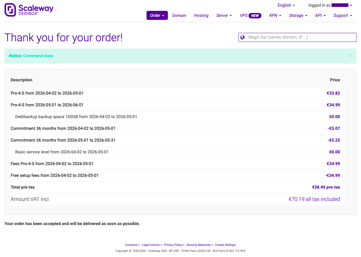

Order a server
Find the server that fits your needs on the server offers page.
For the purpose of this guide, an entry-level enterprise server, the Pro-4-S, equipped with an Intel Xeon E3 1245v5, was used.
Scaleway server order

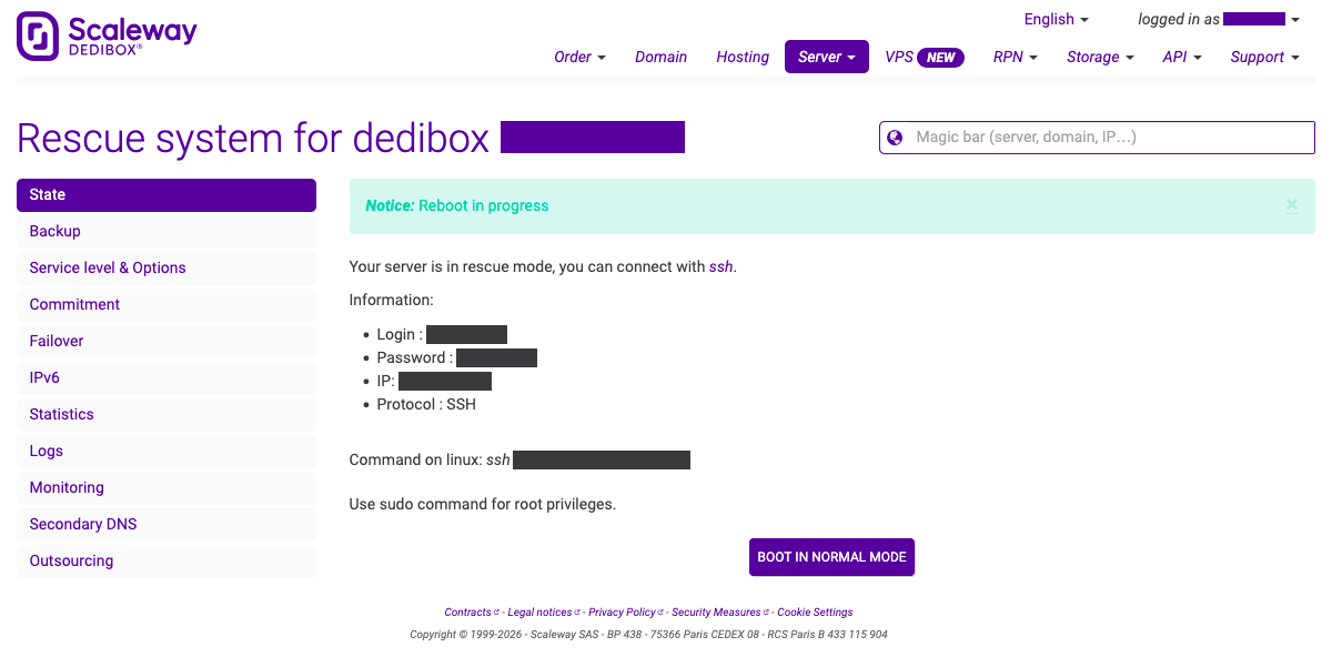

Boot the server in rescue mode
In order to write the IncusOS image onto your server, you first need to click on “INSTALL OVER KVM” in its management interface. After going back to the main page, a button allowing you to boot the server in rescue mode will have appeared; click it. You will get SSH credentials to perform operations after choosing the recovery image you want to boot.
Note
Even though the checkbox reading “I accept that Scaleway support team can connect to my server as long as it is in rescue mode.” is highlighted, you are not required to check it. So, don’t.
Scaleway rescue mode
Remember at the end of this guide to disable the rescue mode.

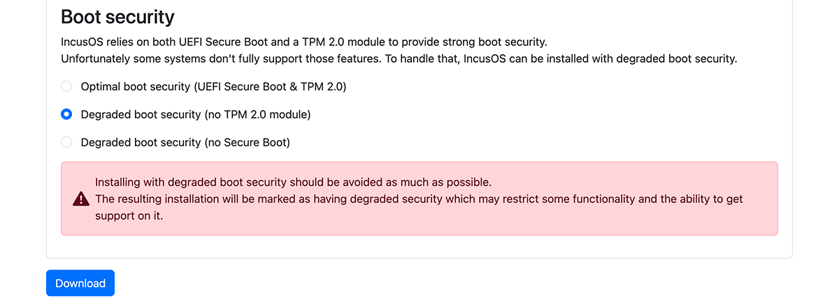

Follow the instructions to get an IncusOS image. For this installation, a USB operation mode image is required.
You don’t need to configure anything specific other than the “Boot security” option, which must be set to “Degraded boot security (no TPM 2.0 module)”.
IncusOS image

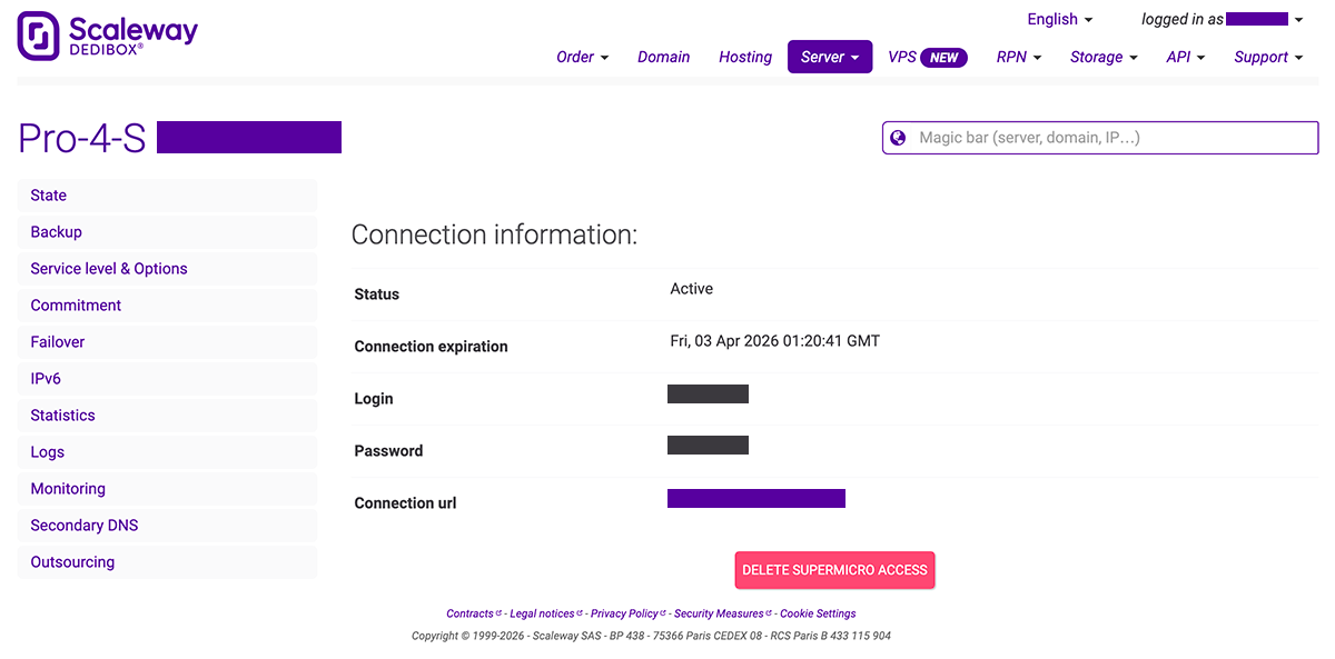

Click “KVM OVER IP” in the server management interface, read carefully and understand the scary warning message, enter your computer’s public IP address to allow access to the KVM interface, then login to your board’s remote management interface.
KVM access
Remember at the end of this guide to revoke the KVM access.

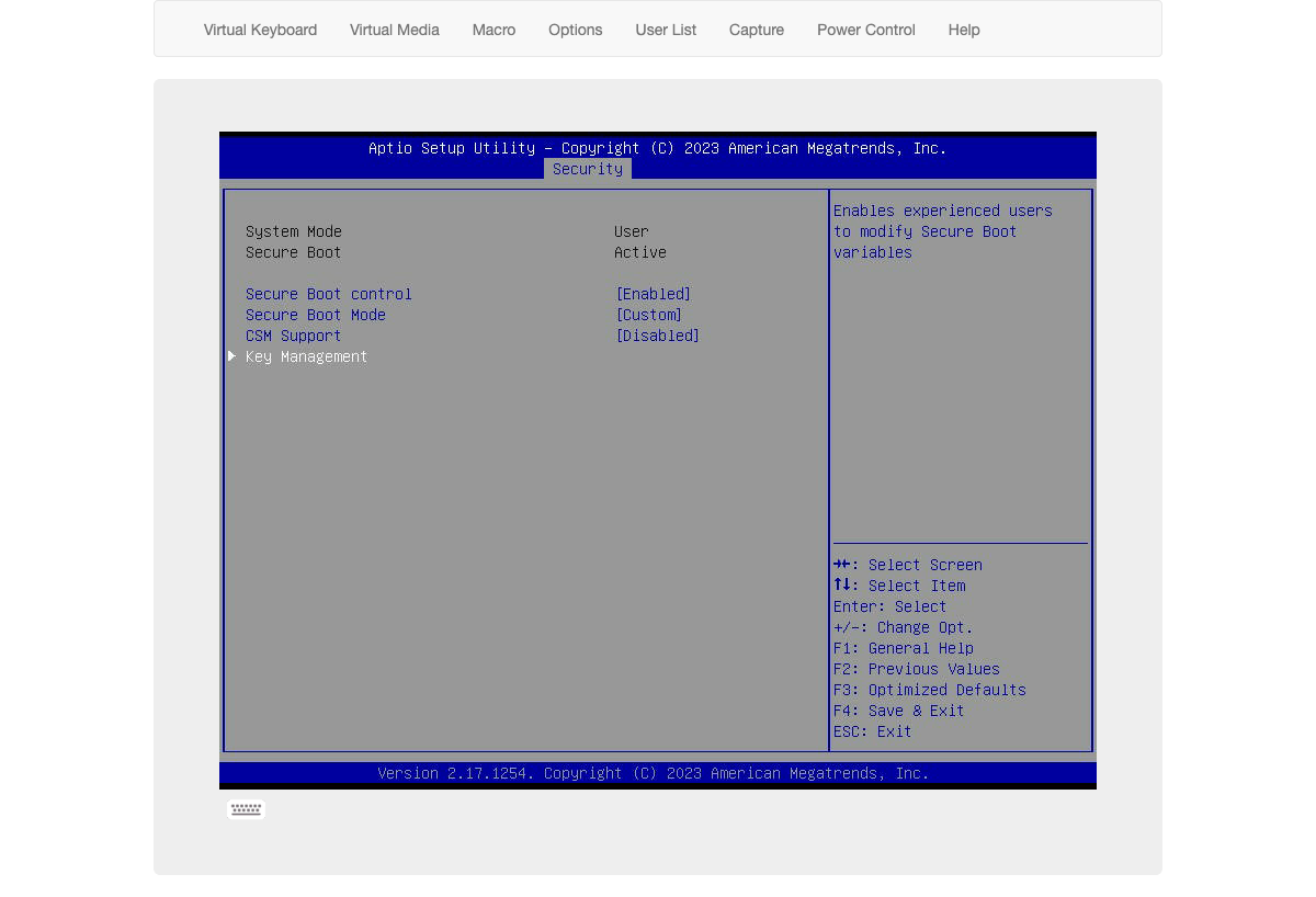

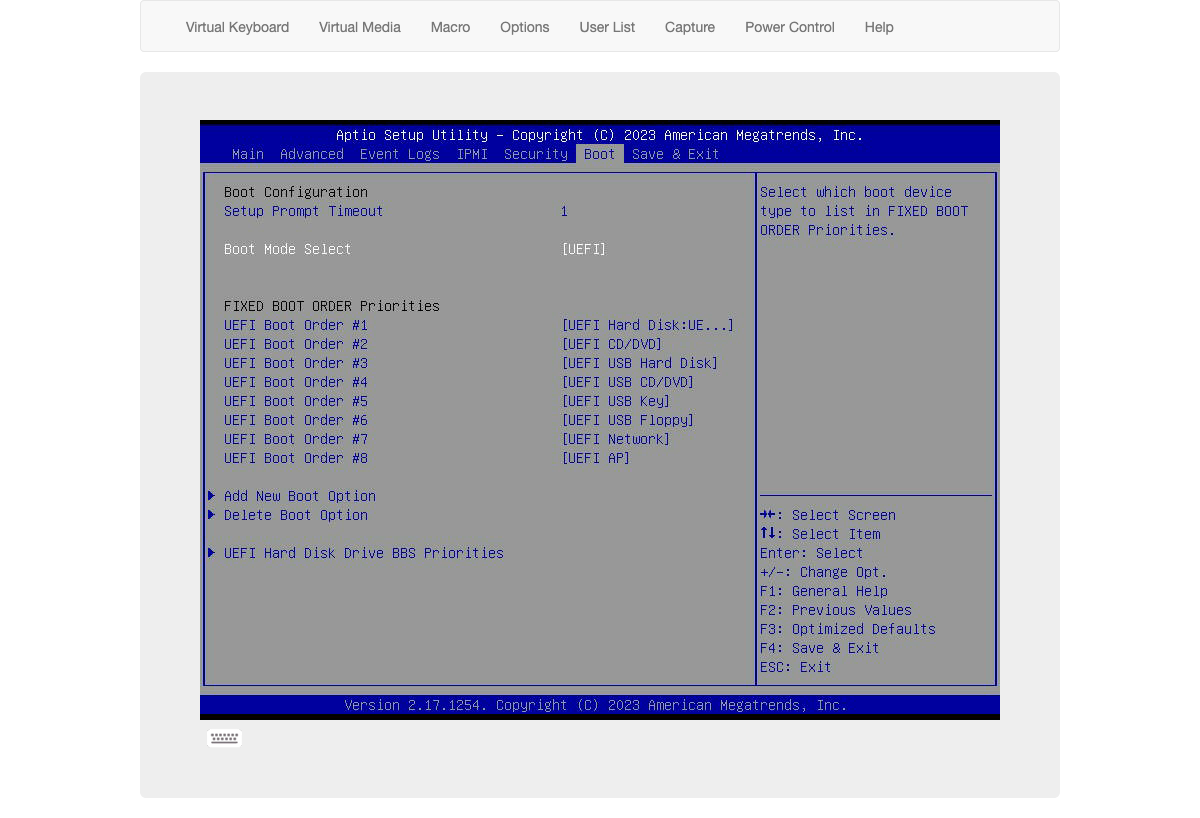

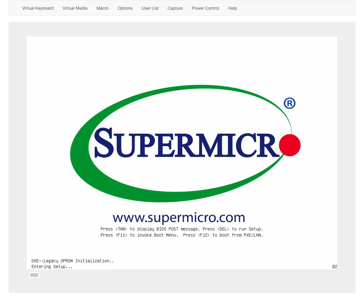

If you end up on a SuperMicro interface, spawn an HTML5 console in Remote Control > iKVM/HTML5, reboot the server, and access the firmware menu, typically by pressing DEL, when prompted. Other manufacturers have different but similar interfaces.
Splash screen

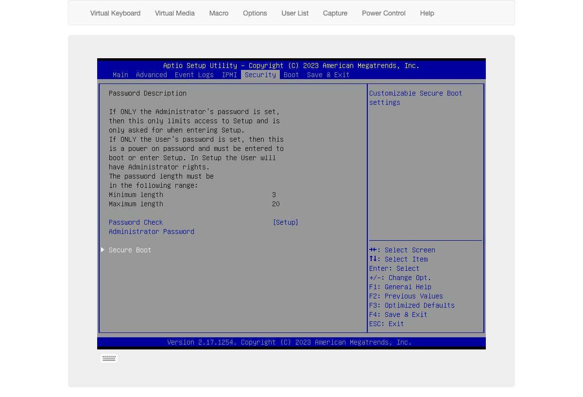

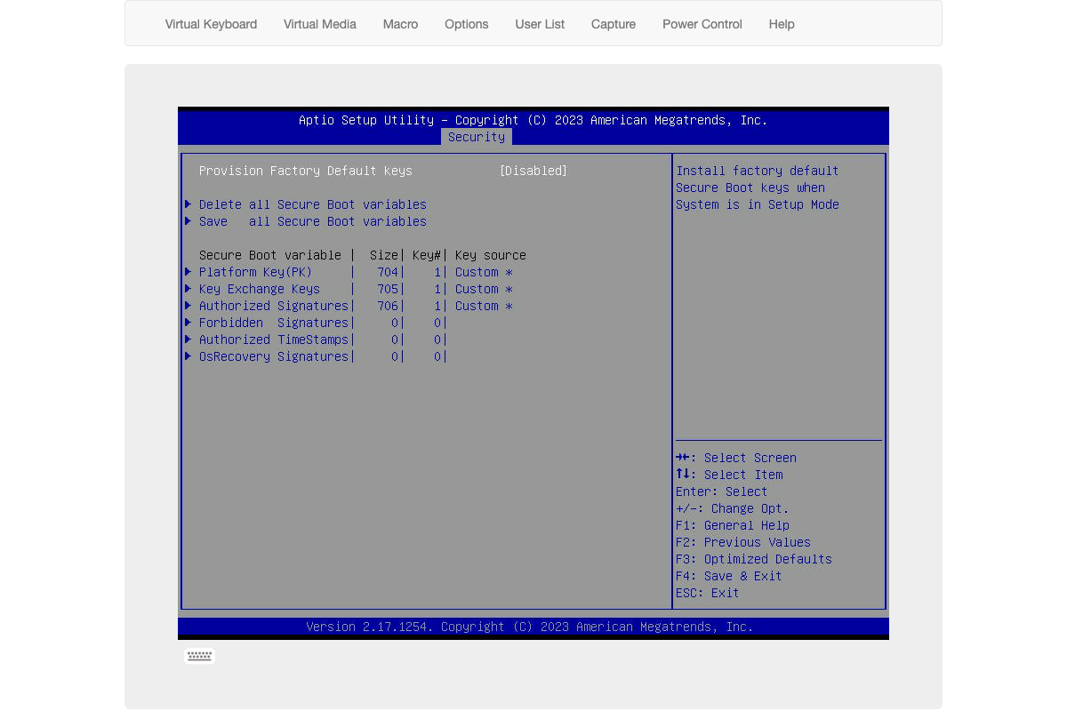

The following steps are roughly:
  • Enable UEFI booting
  • Enable Secure Boot
  • Set Secure Boot in custom mode
  • Wipe Secure Boot databases
  • Load the IncusOS PK, KEK and DB (called “Authorized Signatures” on SuperMicro) keys
  • Save and reboot
Security screen Security > Secure Boot screen Security > Secure Boot > Key Management screen Boot screen

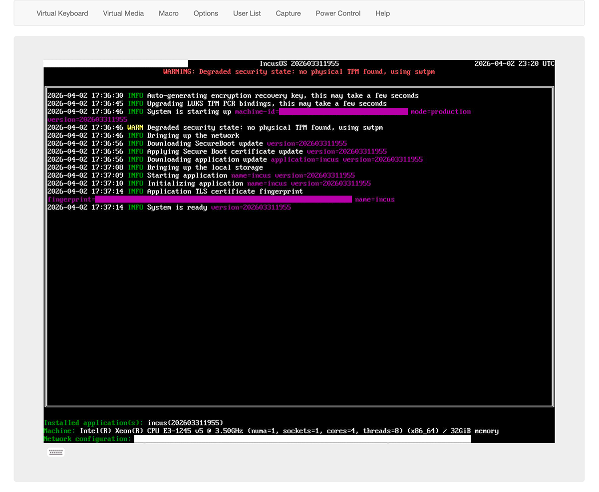

IncusOS is ready for use
The system will now boot into IncusOS.
Server running IncusOS
Once complete, follow the instructions for accessing the system.
