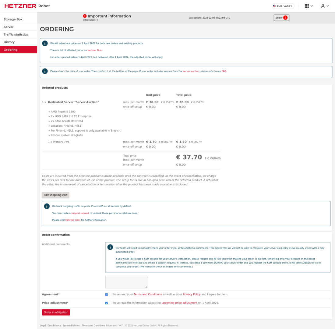

Order a server
Find a suitable server from Hetzner’s server auction or server finder.
For the purpose of this guide, a consumer grade platform using an AMD Ryzen 5 3600 was used.
Hetzner server order

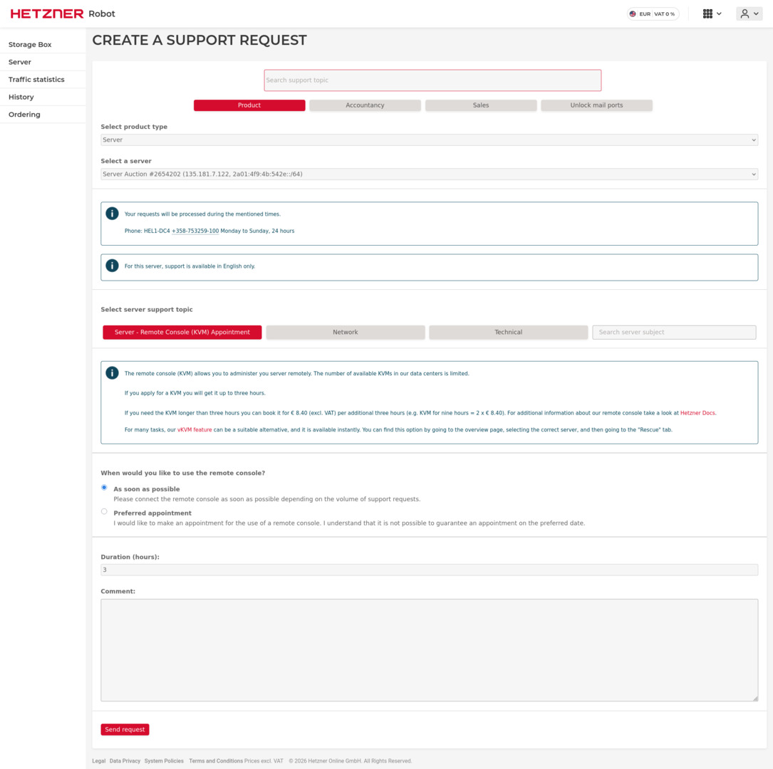

Request KVM access
To configure the system firmware with UEFI Secure Boot and enabling the TPM, you’ll need to request access to a KVM device.
This can be done for free through the support page and will provide you with access from 1 to 3 hours. The procedure only takes a few minutes and KVM access won’t be needed afterwards.

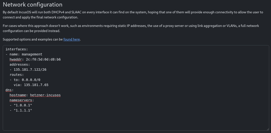

You’ll also need to provide the network configuration for your server. You can get the relevant values either from the Hetzner portal or by querying them from the rescue environment with ip link, ip -4 a and ip -4 r (add ip -6 a and ip -6 r if setting up IPv6 too).
Note
Hetzner commonly performs MAC address filtering on its network, flagging any traffic coming from a MAC address that isn’t registered to the server.
You should therefore set strict_hwaddr: true on the network interface, causing IncusOS to filter outgoing traffic and ensure that only the server’s registered MAC address is ever visible on Hetzner’s network.

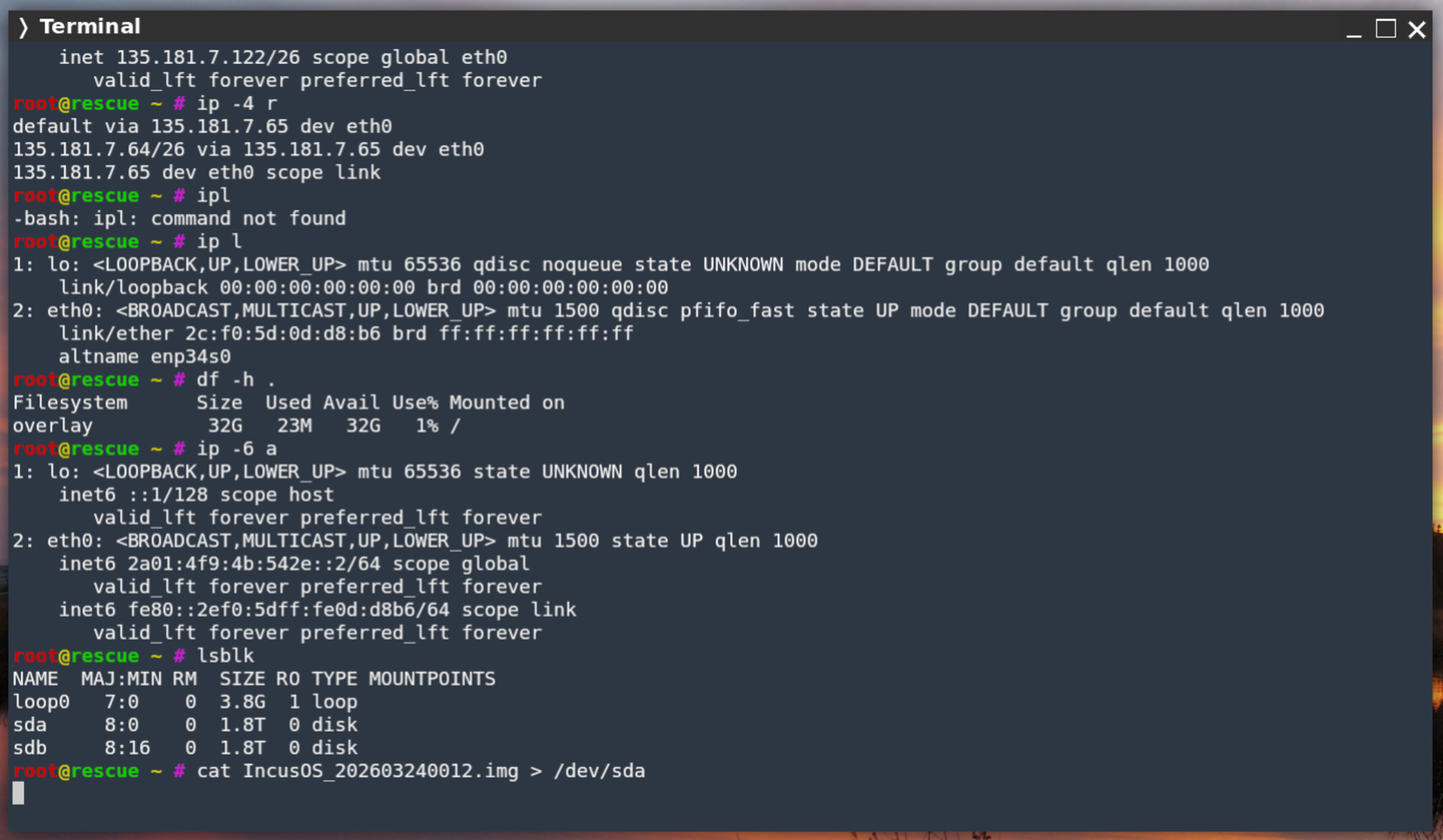

Write the image to disk
Once downloaded, transfer the image over to the server using scp and then write it to disk.
IncusOS installation

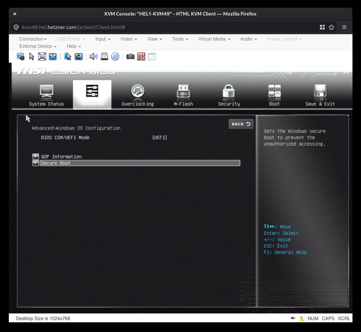

Now you need to use that KVM you requested earlier to reboot the server and go in the firmware menu (by pressing DEL or F2).

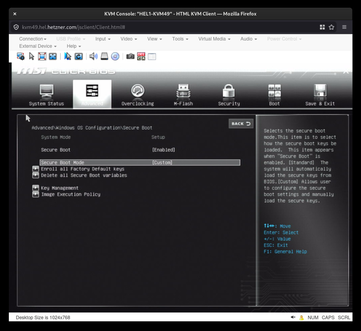

The following steps may vary based on the exact platform but the general steps are:
  • Enable UEFI booting
  • Enable Secure Boot

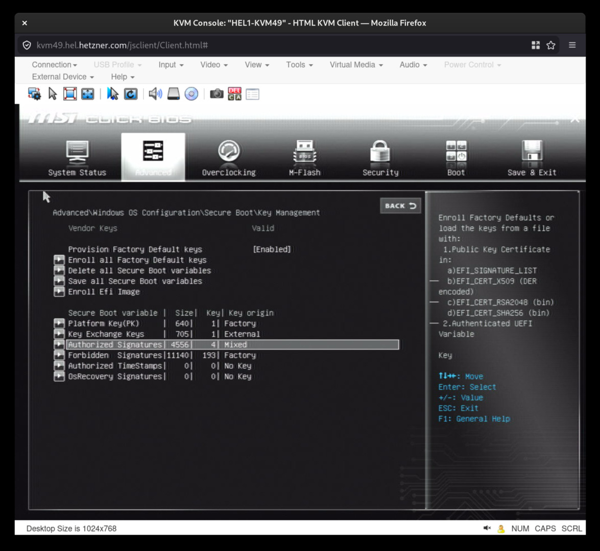

  • Set Secure Boot in custom mode
  • Wipe the KEK database and load the IncusOS KEK
  • Wipe the DB database and load the IncusOS DB keys (if system fails to boot, only append the keys)

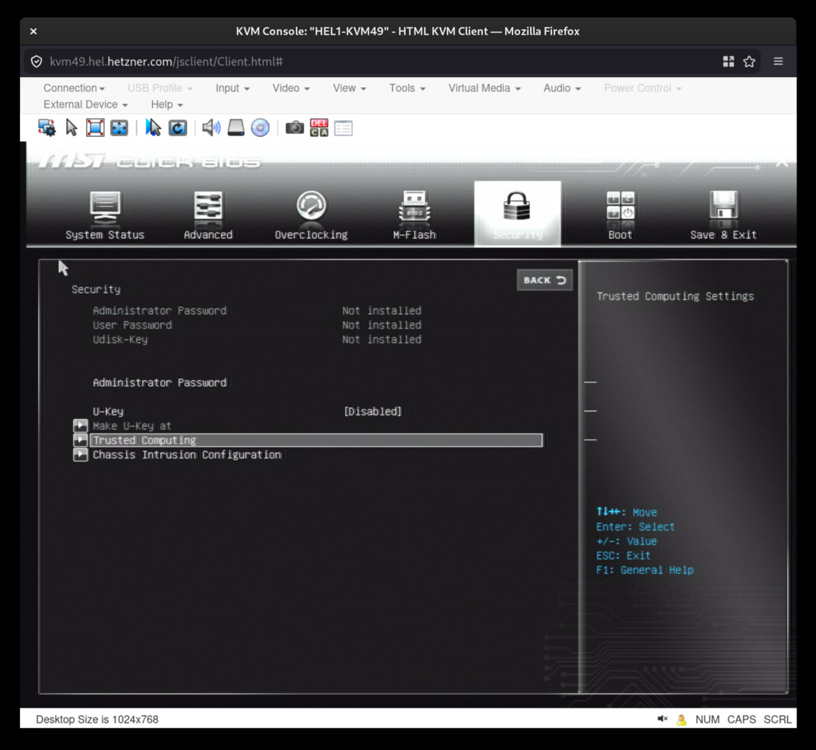

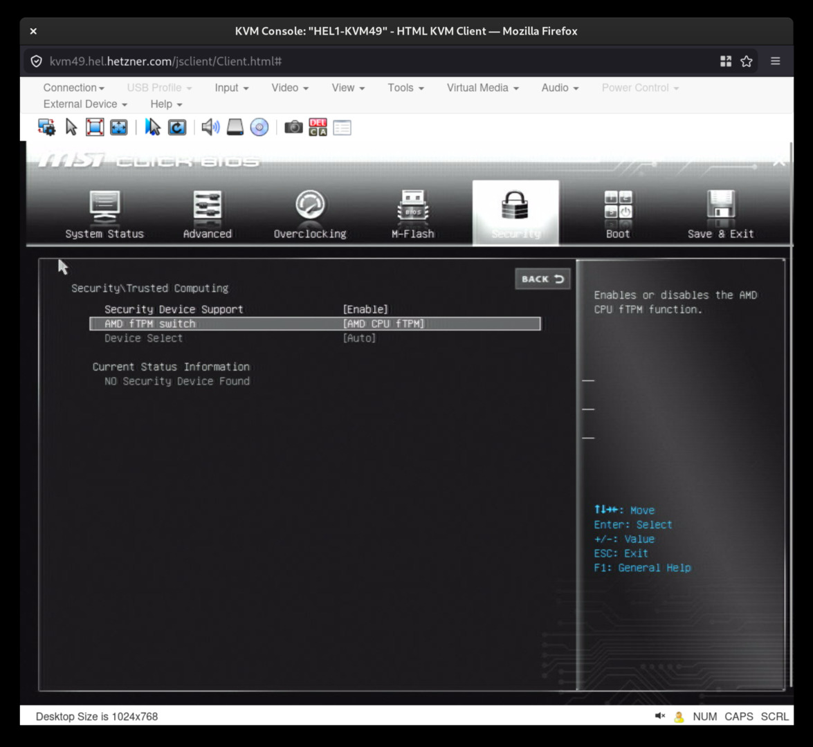

  • Enable the TPM device
  • Save and reboot
UEFI settings Secure Boot settings Secure Boot configured TPM settings TPM configured

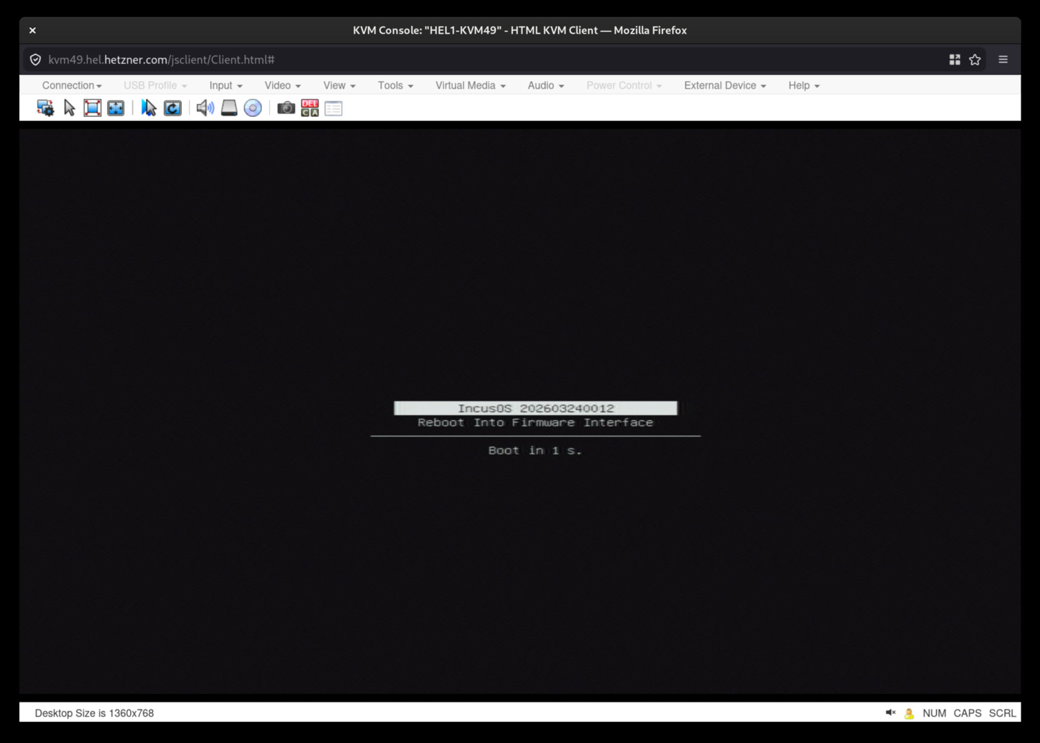

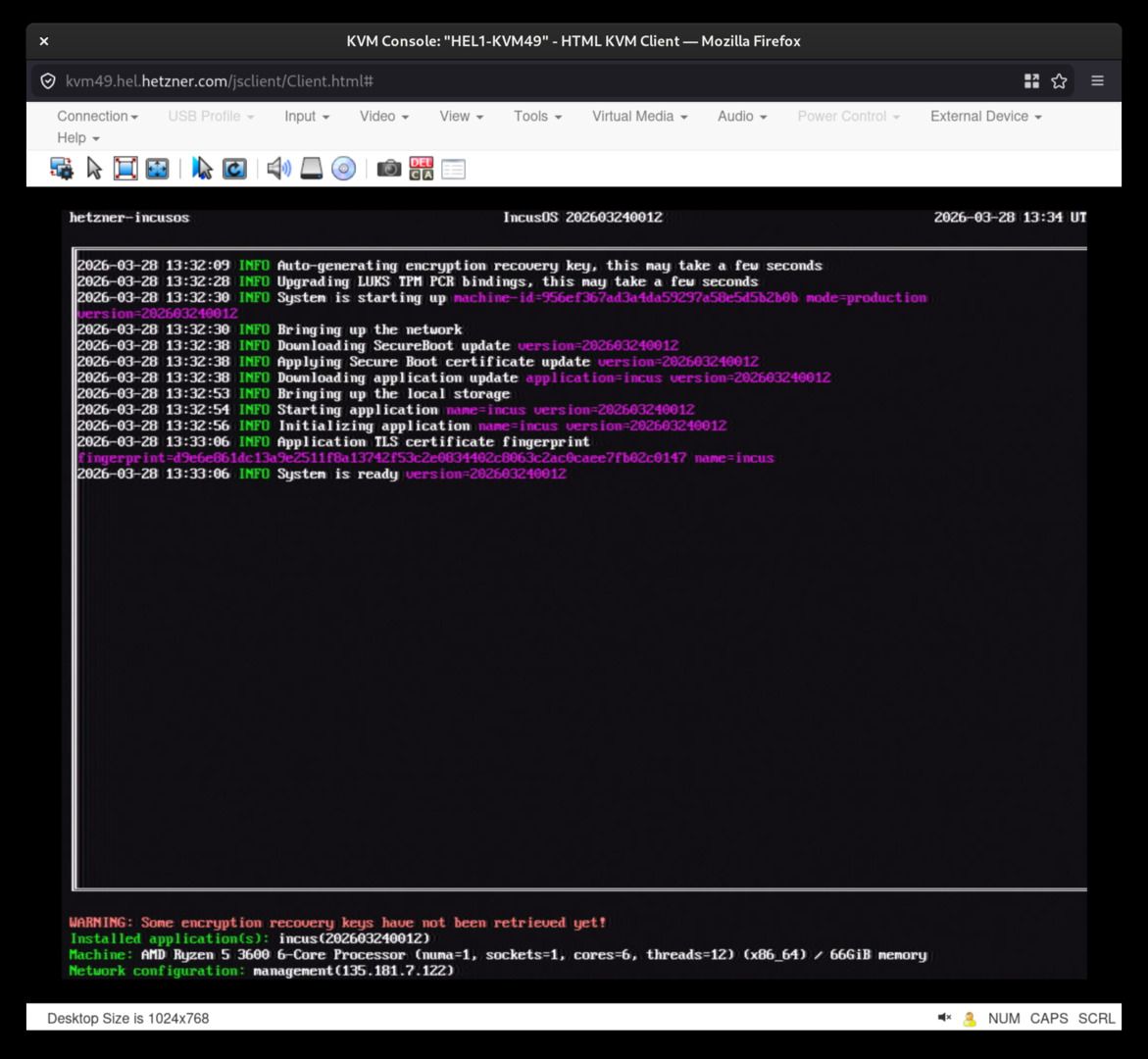

The system will now boot into IncusOS.
Server booting
And after a little while, it will show the fully booted IncusOS.
Server running IncusOS
Once complete, follow the instructions for accessing the system.
