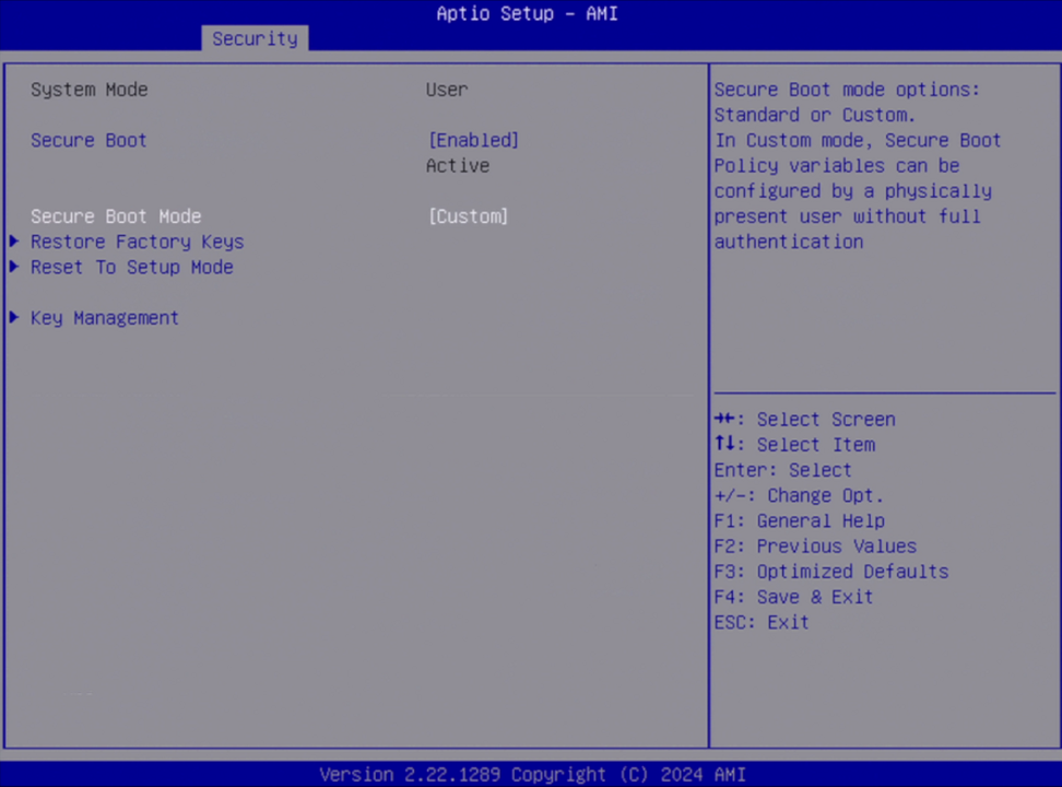

Turn on and configure Secure Boot
Use the “custom” security policy
If available, ensure the system is in “user” mode

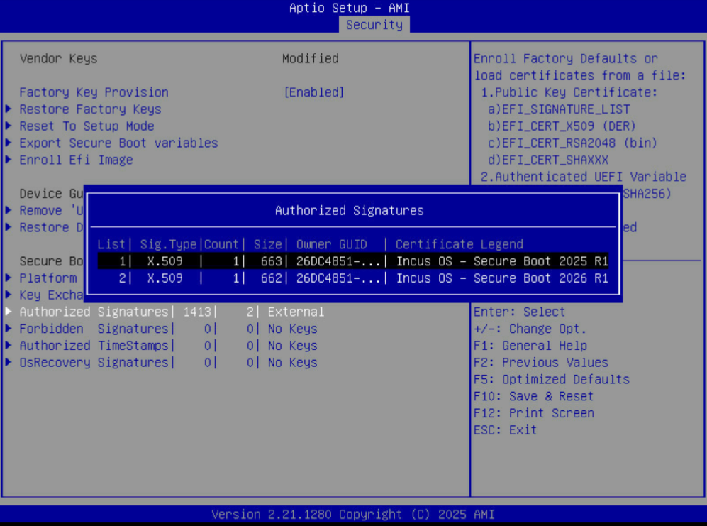

Load the IncusOS keys from the installation media (
keys/folder in EFI ESP partition):Wipe everything from KEK and load the IncusOS KEK key
Wipe as much as possible from DB and load the IncusOS DB key(s)

In those scenarios, you’ll want to instead manually enroll the IncusOS KEK and DB keys, assuming your firmware provides an option for this.
The install media contains a keys folder which has the .der version
of all three keys that need to be enrolled. Exact mechanism for manual
enrollment varies widely between vendors.

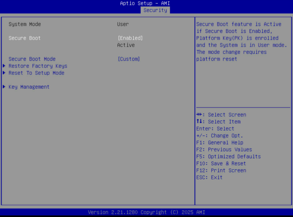

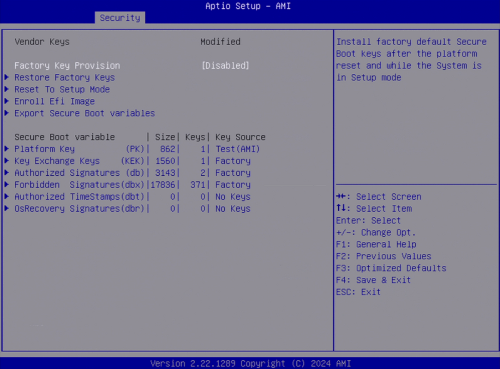

Asus servers use an AMI Aptio based firmware with a standard layout.
Those servers don’t require additional Secure Boot keys be loaded to handle regular boot operations, as a result, all DB keys can be safely wiped.

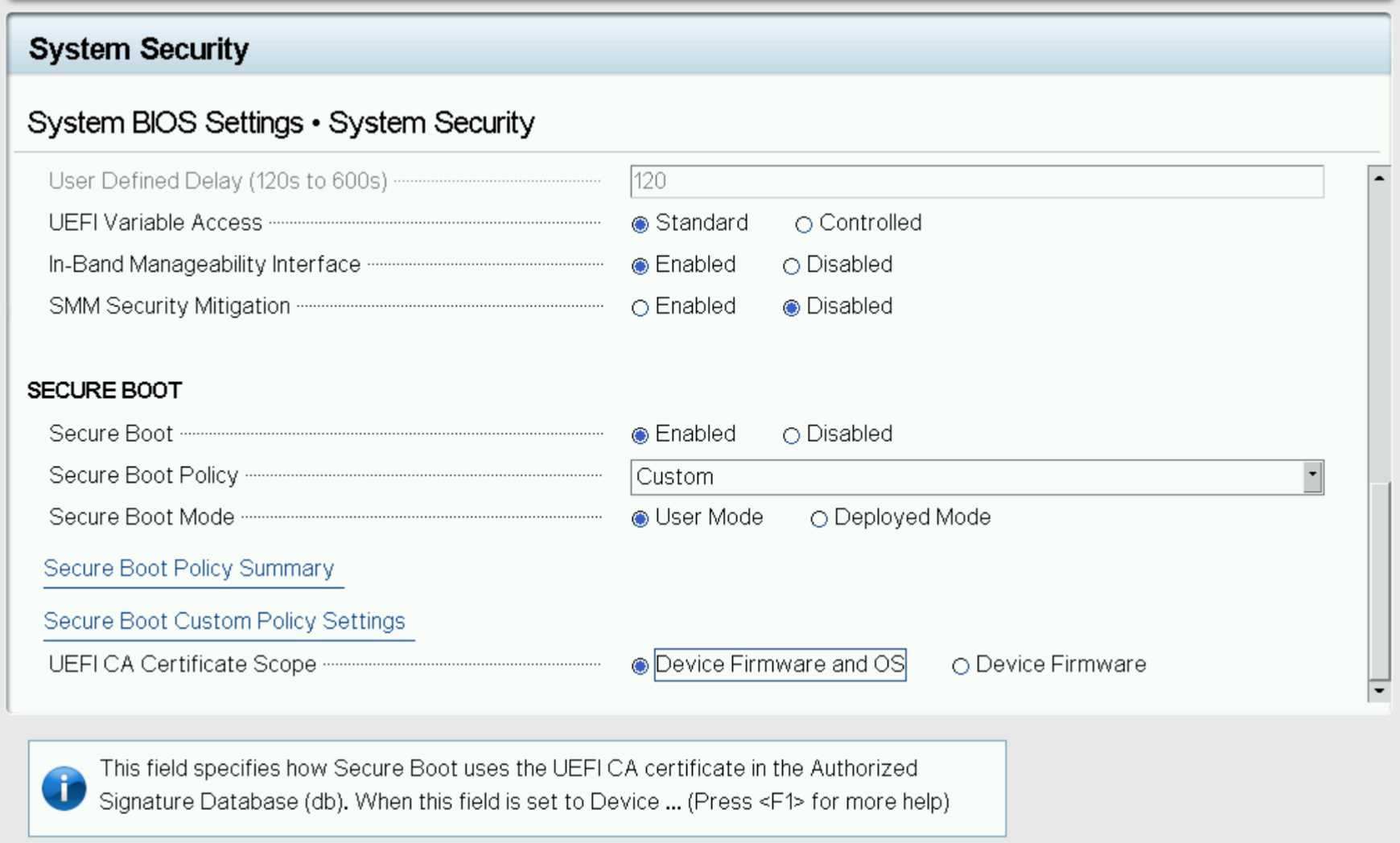

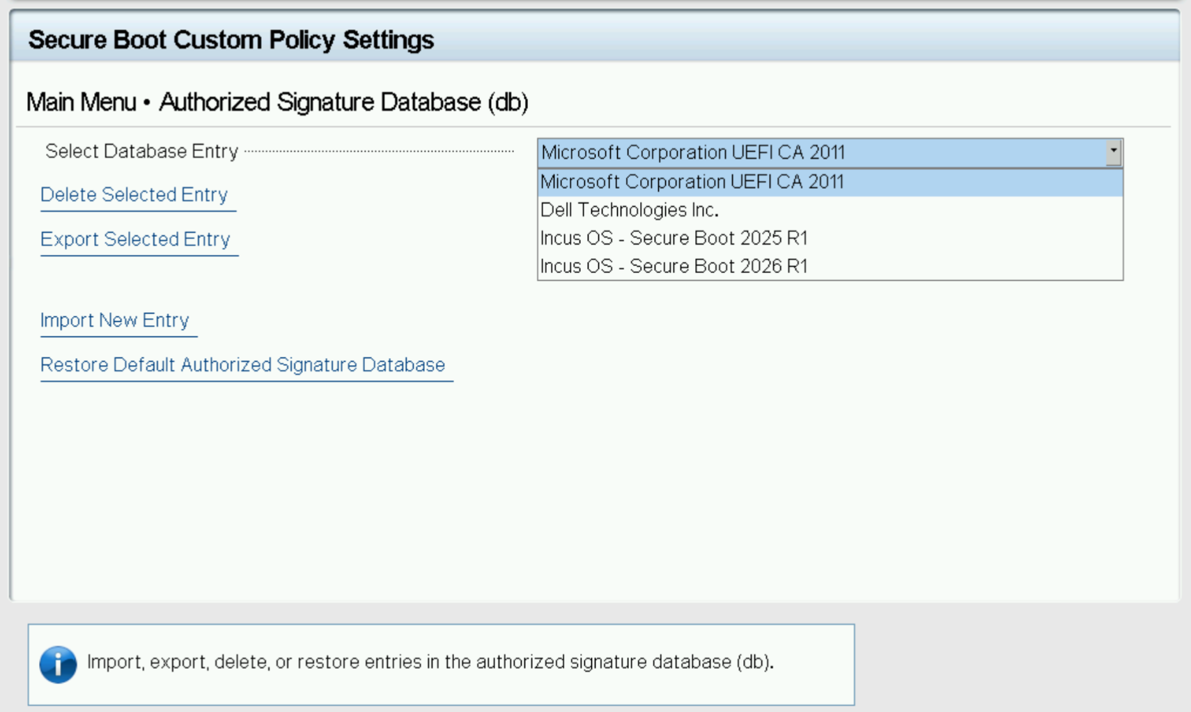

DELL servers provide a full Secure Boot configuration.
The NVME and storage controllers in those servers often rely on the Microsoft UEFI CA in order to boot, as a result those keys should be retained in DB.

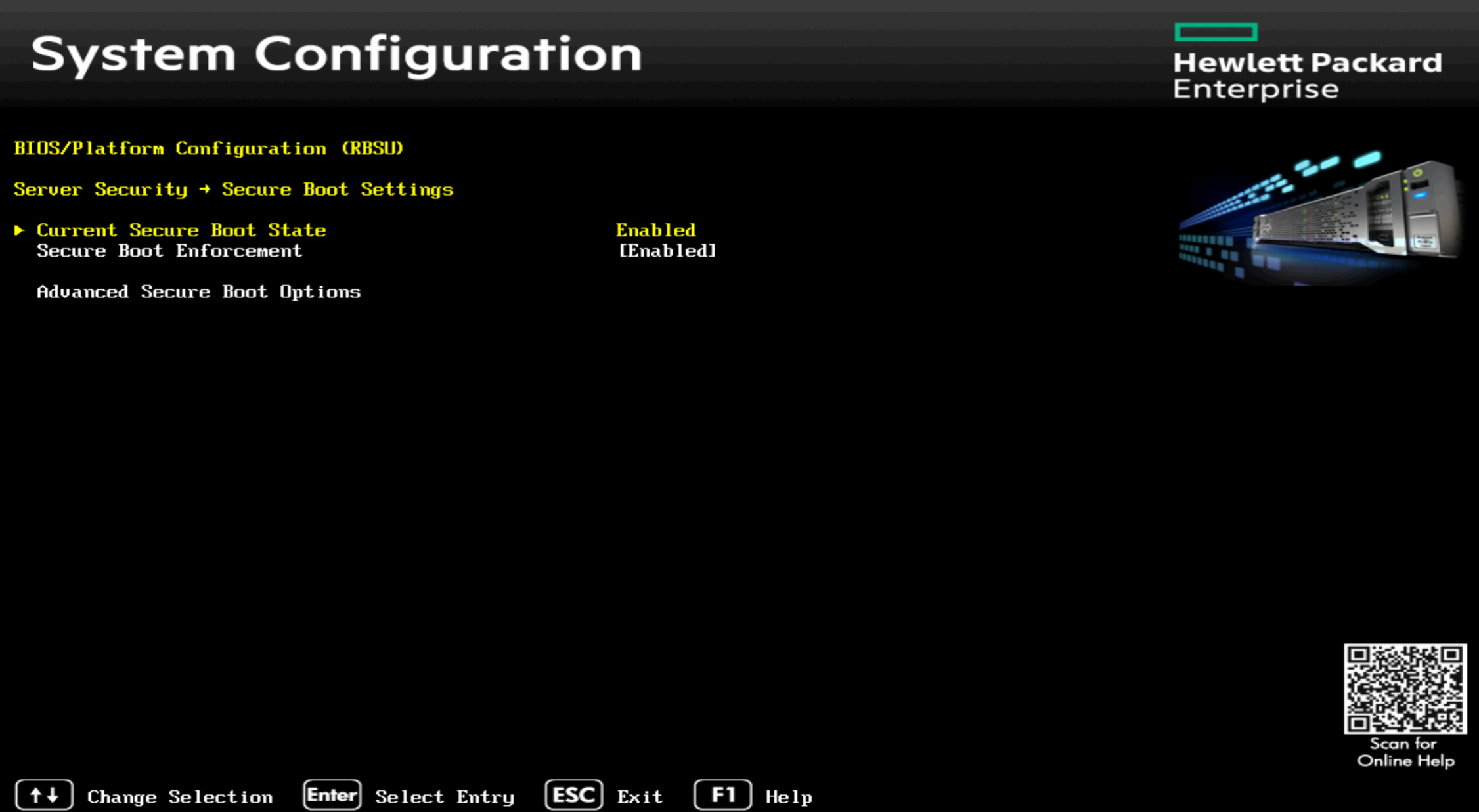

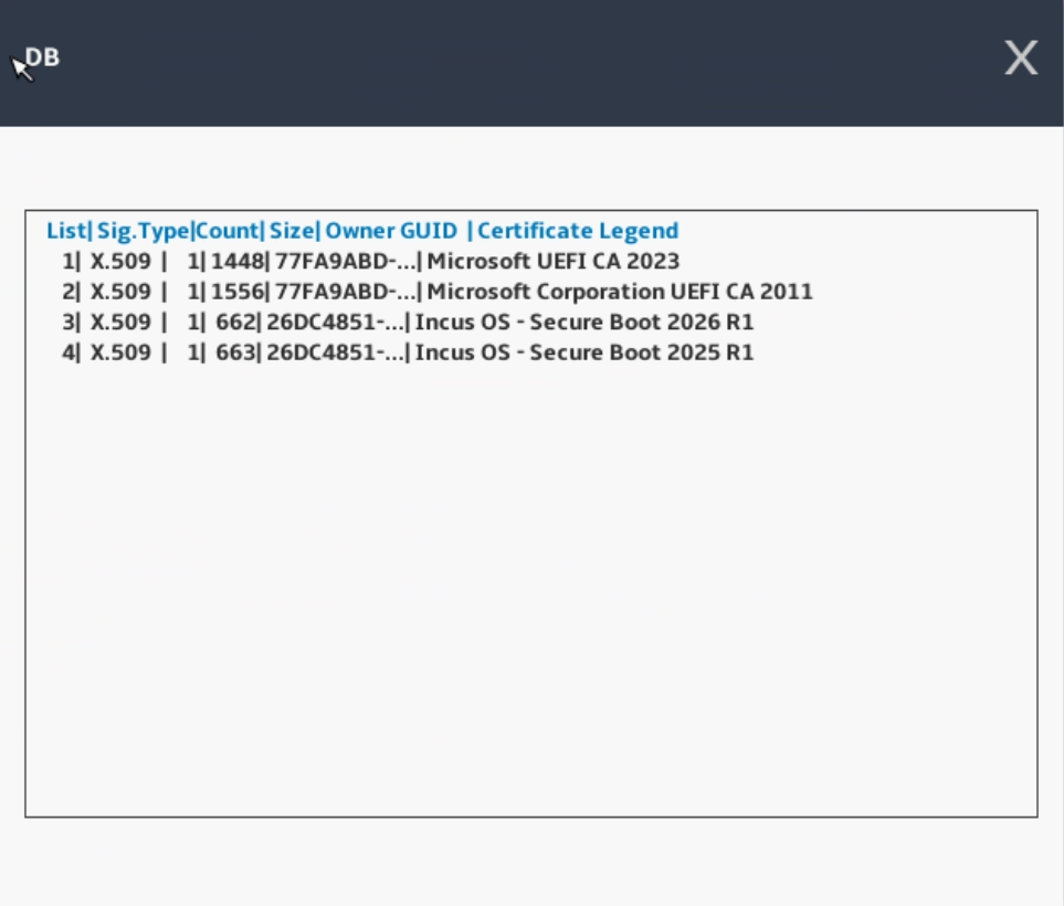

HP servers don’t offer much visibility on the exact Secure Boot policy in place.
They do still allow clearing all keys and loading custom ones and those servers don’t appear to typically rely on additional Secure Boot keys in order to boot.

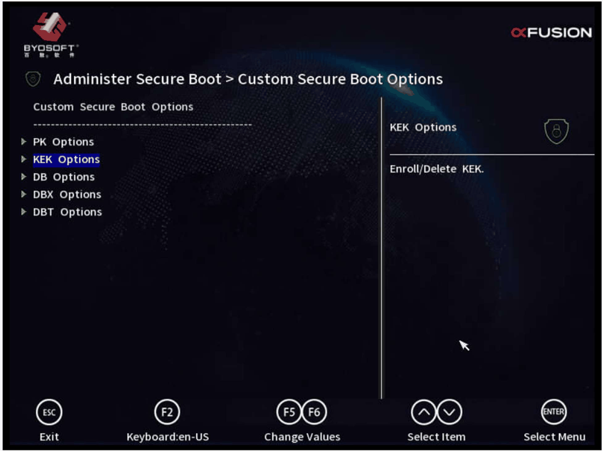

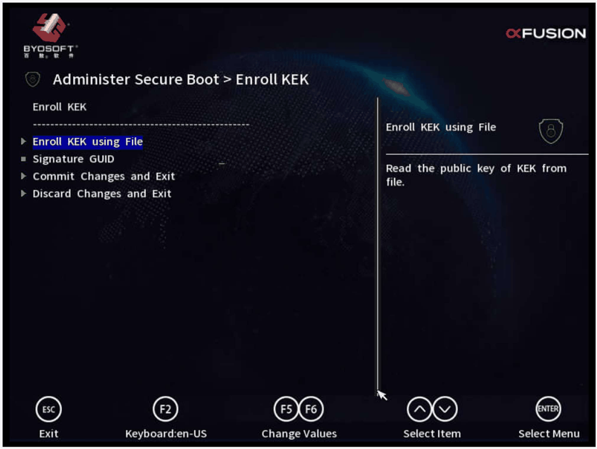

Huawei and xFusion servers (tested on the xFusion V7 generation) use a BYOSOFT based firmware with a full Secure Boot configuration.
Those servers don’t appear to rely on additional Secure Boot keys in order to boot and the preexisting PK can be kept in place, so only the IncusOS KEK and DB keys need to be enrolled.

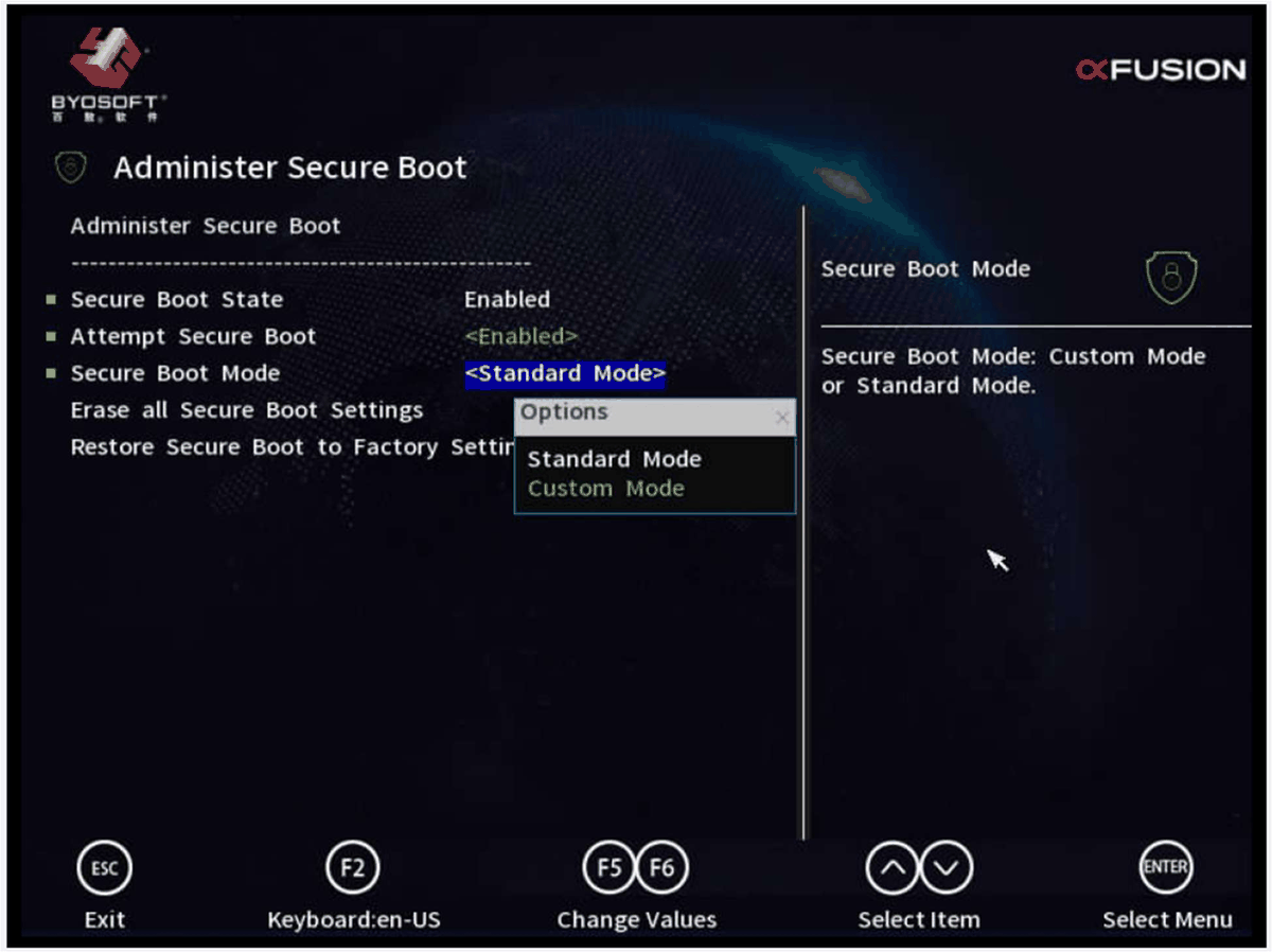

In the firmware front page, select “Administer Secure Boot”, then set “Secure Boot Mode” to “Custom Mode” and enter “Custom Secure Boot Options”.

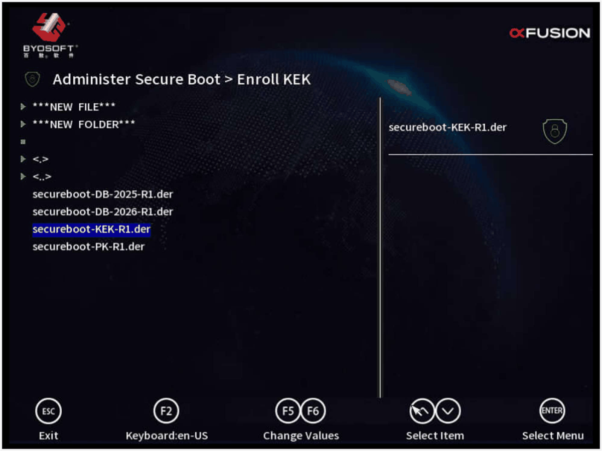

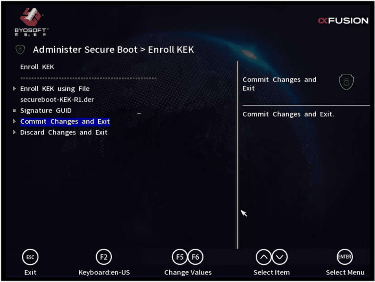

In “KEK Options”, select “Enroll KEK” then “Enroll KEK using File”,
navigate to the install media ESP partition and select
secureboot-KEK-R1.der from the keys folder, then select “Commit
Changes and Exit”.

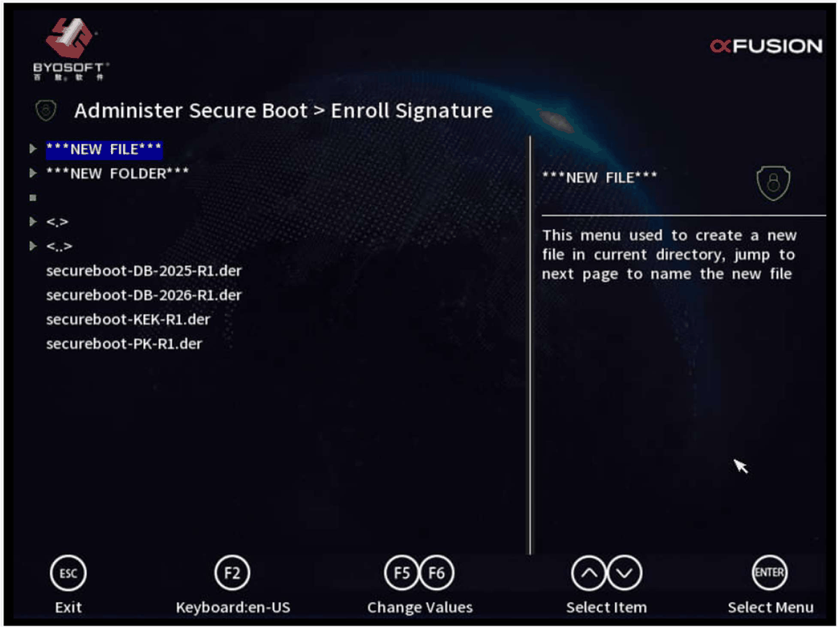

In “DB Options”, select “Enroll Signature” then “Enroll Signature Using
File” and enroll both DB keys from the same keys folder, selecting
“Commit Changes and Exit” after each enrollment.
When booting the install media, a “UEFI Secure Boot Verify Success” message confirms the keys were correctly enrolled.

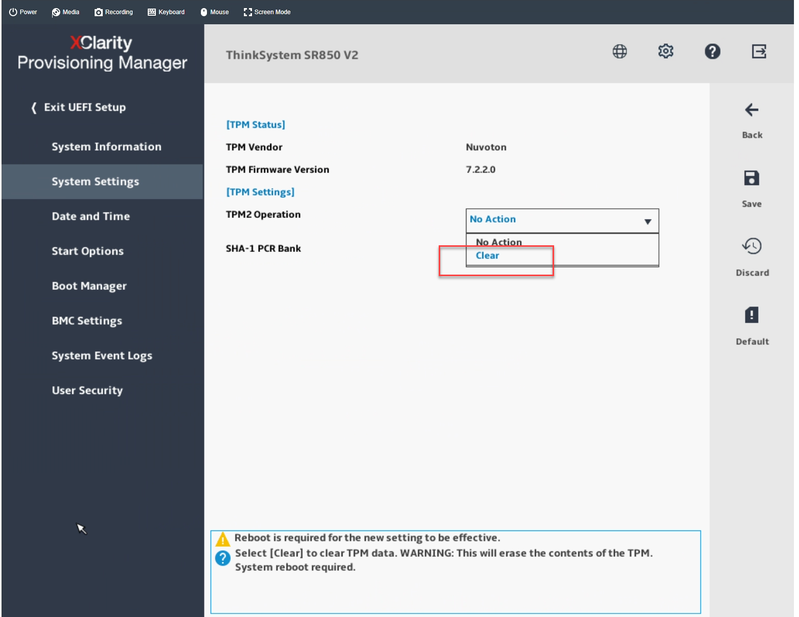

Additionally, we’ve observed a number of systems running into issues due to preexisting TPM state on those systems. A TPM clear is recommended prior to installation.
SuperMicro servers use an AMI Aptio based firmware with a standard layout.

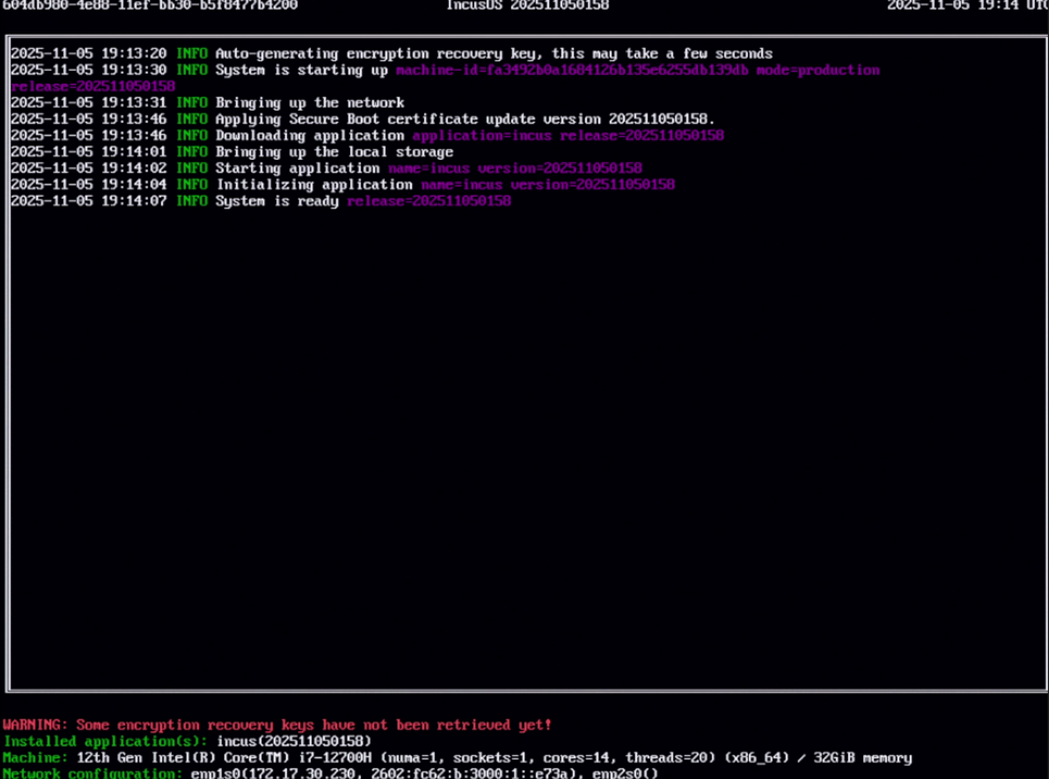

At the end of the installation, you will be prompted to disconnect the install media, the system will then reboot into the installed IncusOS system.
IncusOS is ready for use¶
After reboot, IncusOS will perform its first boot configuration. Once complete, follow the instructions for accessing the system.
