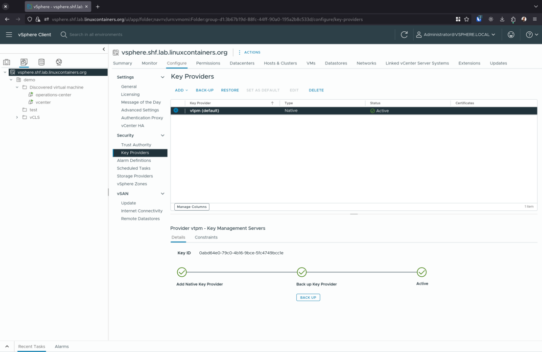

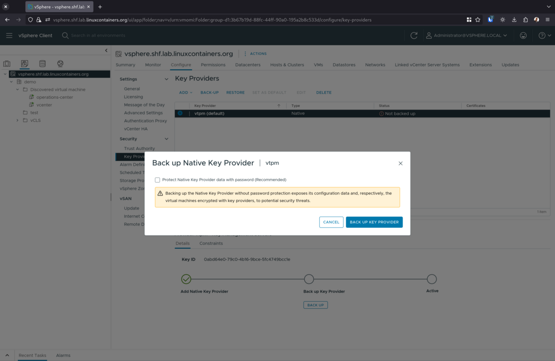

Configure a key provider
To be able to use virtual TPM devices with VMware, you need to have a suitable key provider defined in vSphere.
key provider list
If you don’t have one already, create a new native key provider.
key provider creation
And then back it up to complete its initialization.
You’ll then have a functional key provider and will be able to attach TPM devices to virtual machines.
key provider list

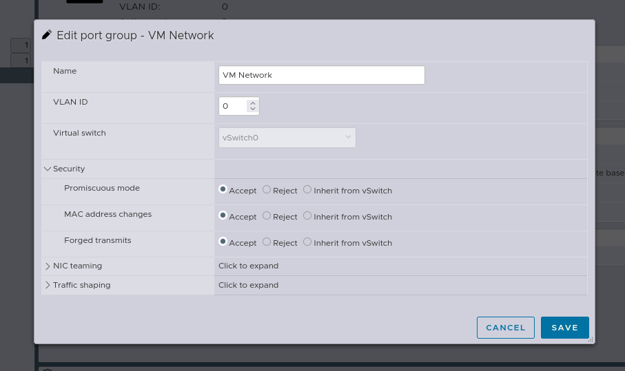

Configure networking
Because IncusOS needs runs nested container and virtual machines, the VMware network security policy must be pretty relaxed to allow for the virtual machine to run its internal bridge.
Network configuration

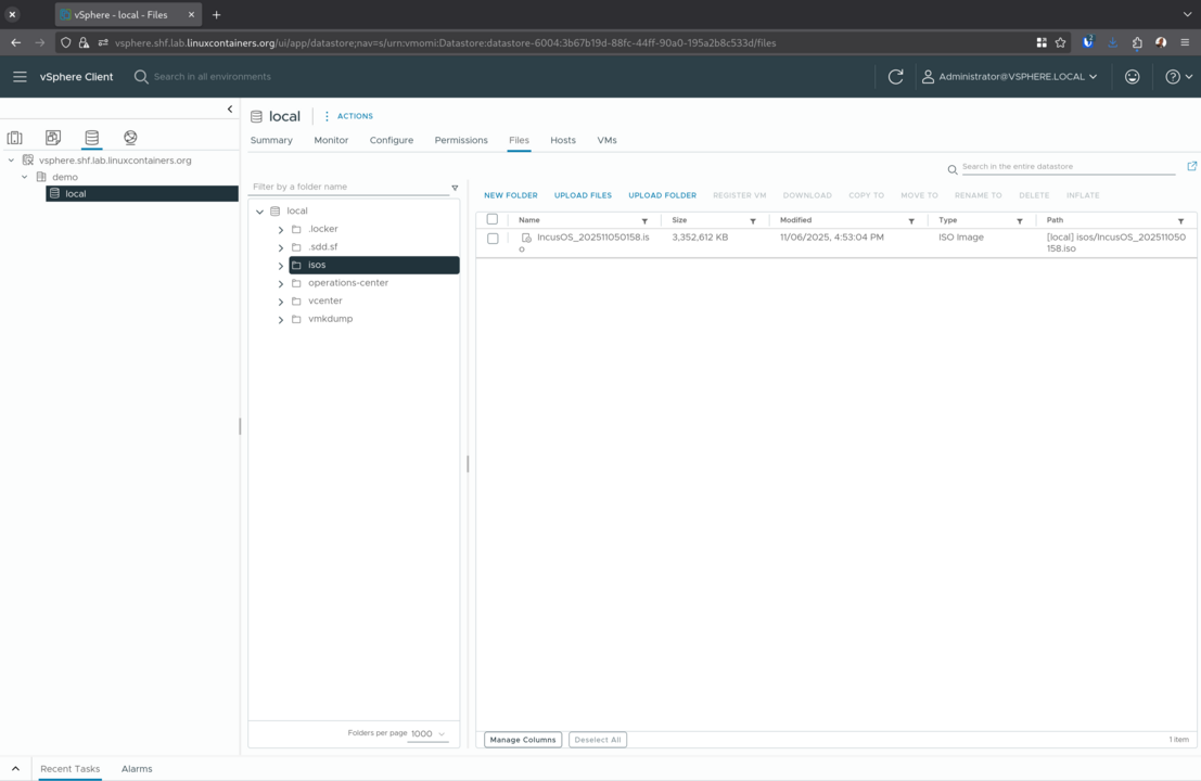

Follow the instructions to get an IncusOS image. This document will assume an ISO image is used.
Once downloaded, upload the ISO image to a VMware datastore.
ISO upload in VMware datastore

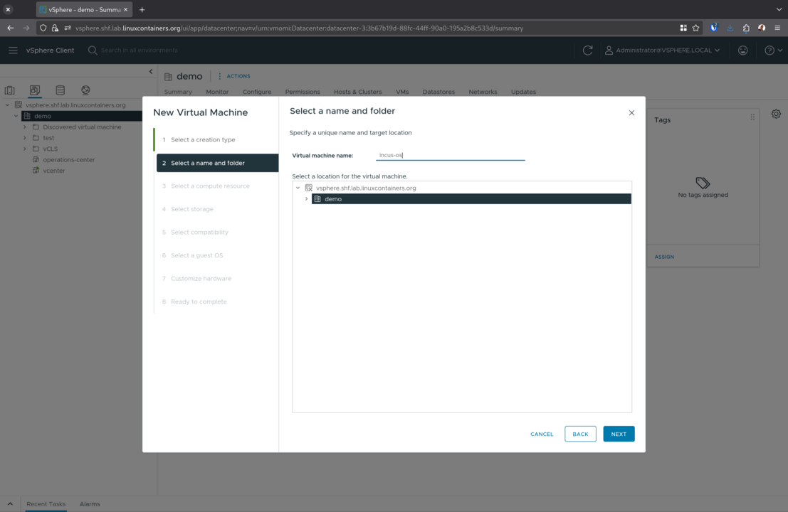

Create a new virtual machine
Pick a name and location.
Set VM name and location

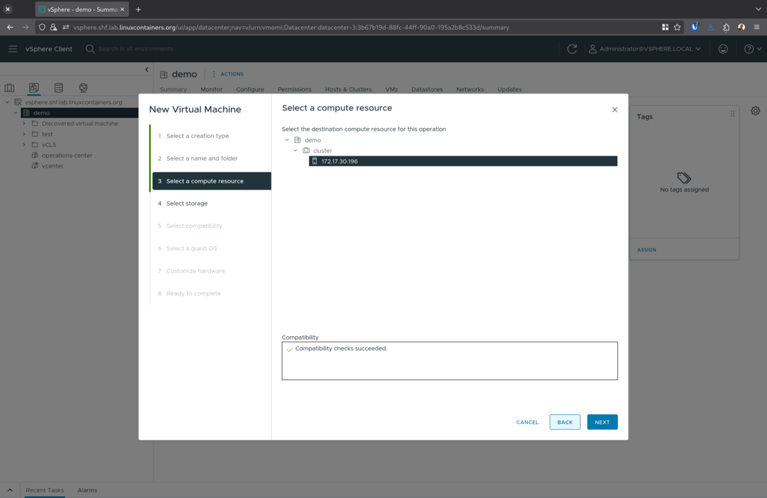

Pick a server to run the virtual machine on.
Set server

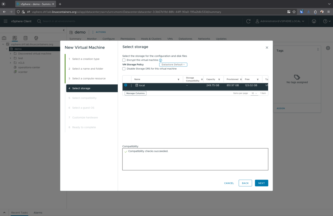

Select a datastore for the root disk.
Select datastore

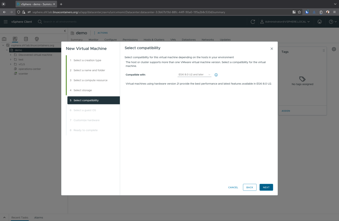

Select the compatibility level (default is fine).
Pick compatibility level

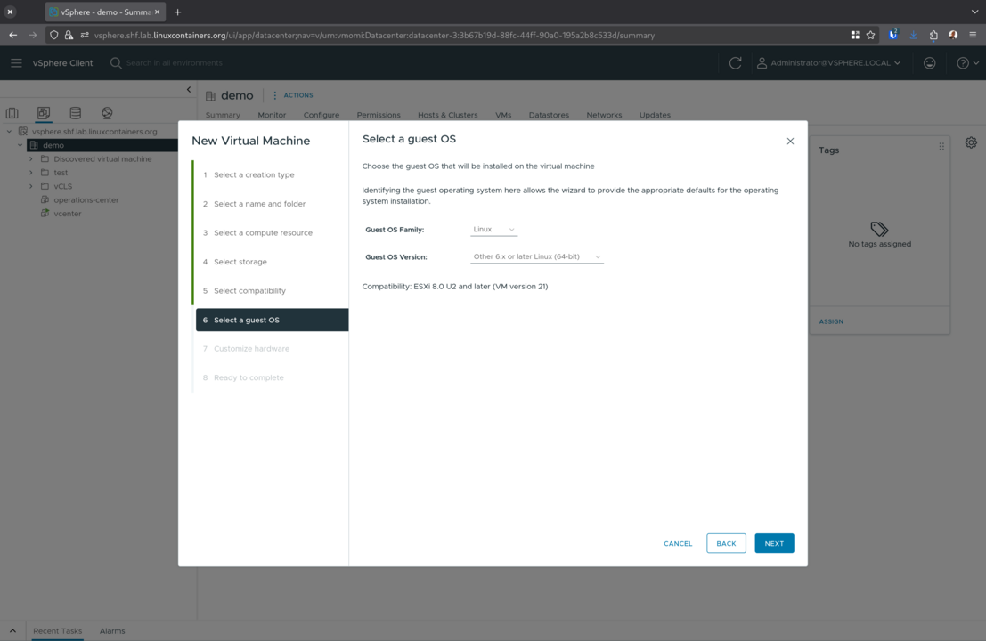

Select Linux and Other 6.x or later Linux (64-bit) as the operating system.
Select operating system

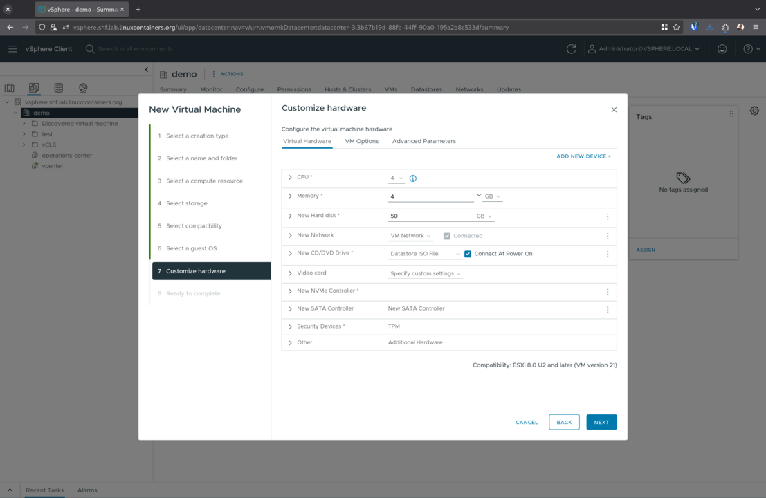

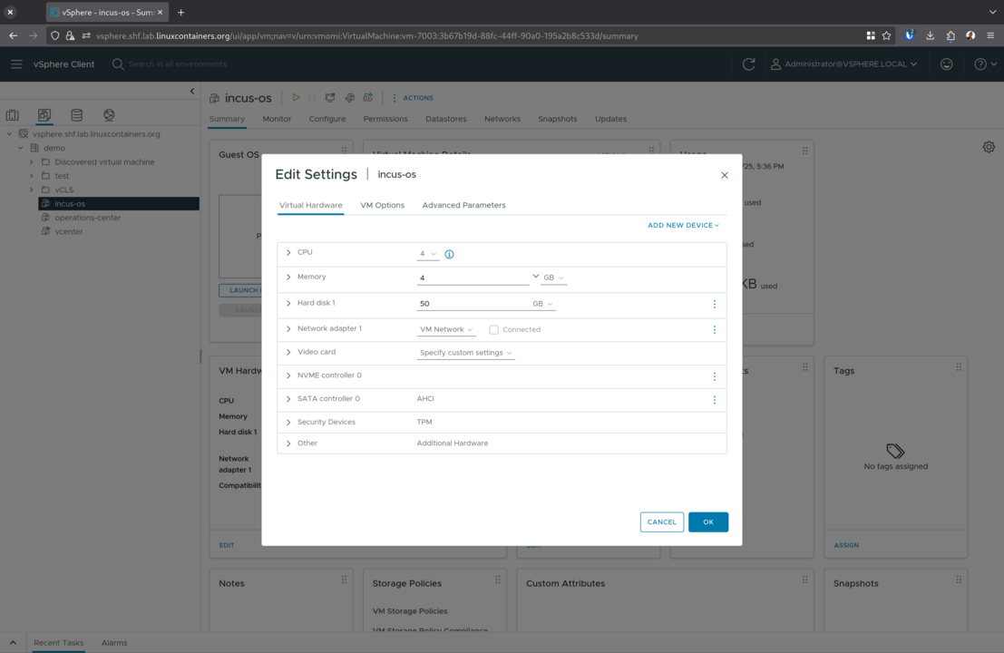

Customize the virtual machine hardware, recommended changes are:
  • Set at least 4 CPUs and 4GiB of RAM
  • Add a NVMe controller
  • Set the root disk size to 50GiB and attach it to the NVMe controller
  • Detach the SCSI controller (now unused)
  • Attach a TPM module
  • Attach the previously uploaded ISO image to the CDROM device and make sure to have it connect on start-up

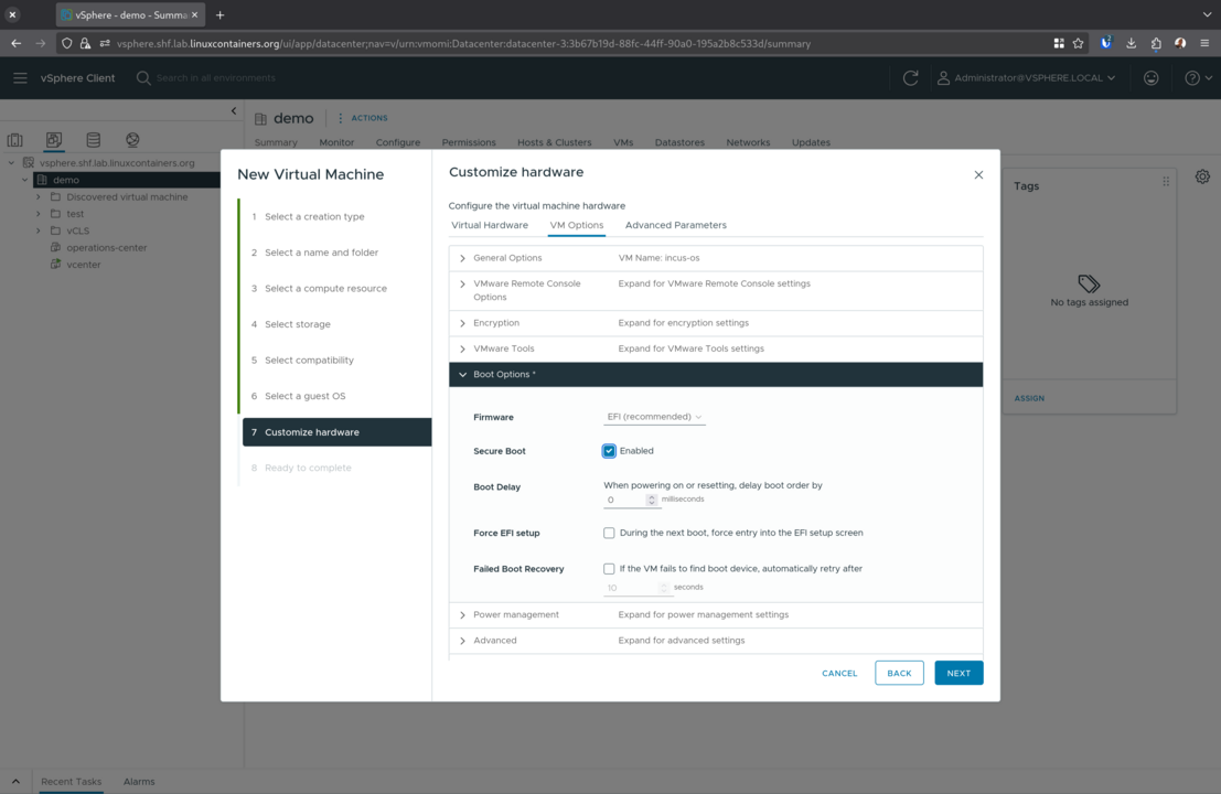

In the options tab, under Boot Options, make sure that Secure Boot is enabled.
Enable Secure Boot

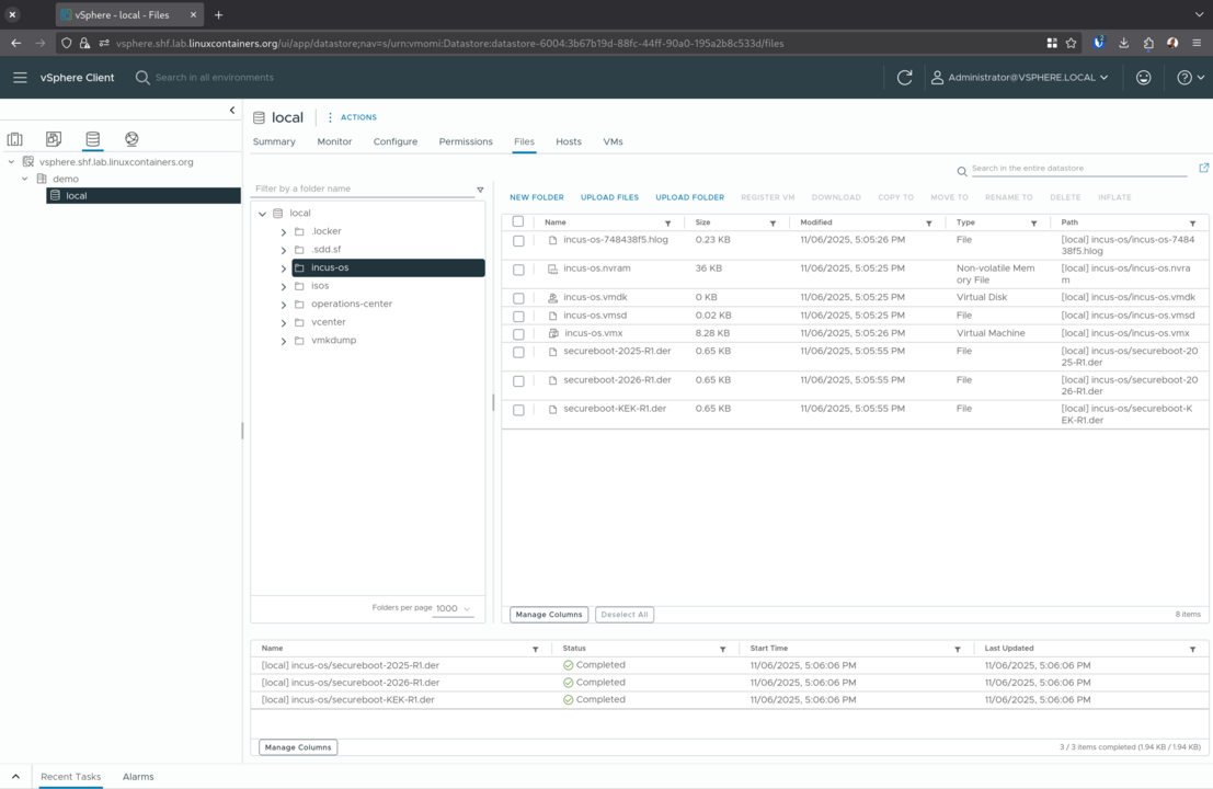

Upload the Secure Boot keys
Open the datastore view and go to the virtual machine’s folder.
Then go to https://images.linuxcontainers.org/os/keys/ and download:
  • secureboot-KEK-R1.der
  • secureboot-DB-2025-R1.der
  • secureboot-DB-2026-R1.der
Once downloaded, upload those three files to the virtual machine’s folder.
Upload Secure Boot keys

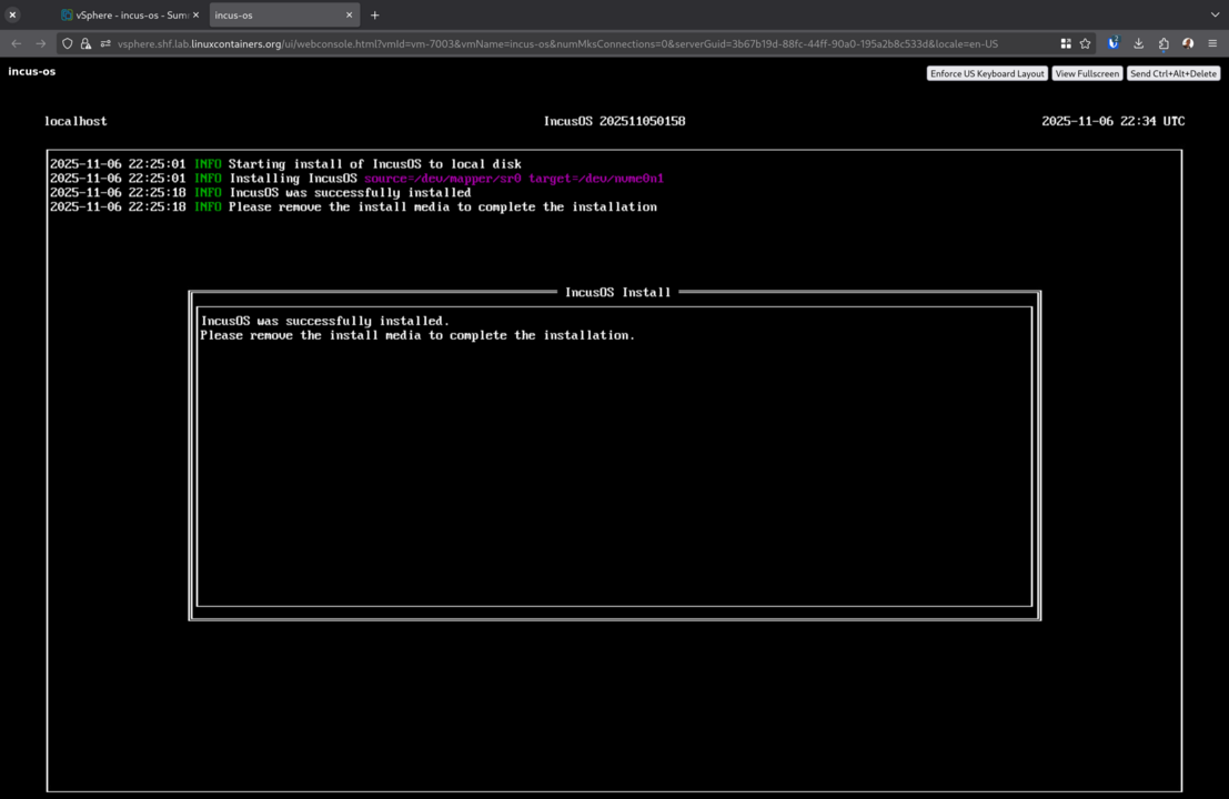

IncusOS installation
Start the virtual machine, and IncusOS will begin its installation.
Note
VMware takes a very long time to hash the kernel image during boot. This leads to a black screen lasting around 3 minutes following the boot loader message.
Installation
Once installed, stop the virtual machine and edit its settings to disconnect the CDROM device.
Detach the ISO

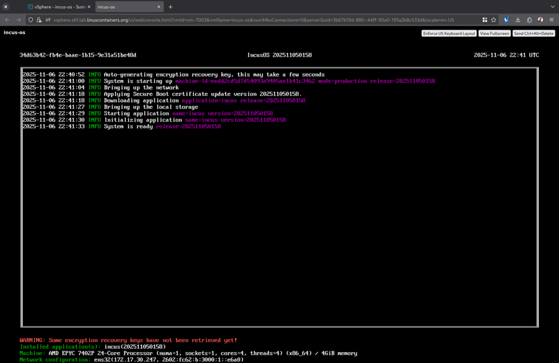

IncusOS is ready for use
Start the virtual machine, and IncusOS will perform its first boot configuration. Once complete, follow the instructions for accessing the system.
Installed system
